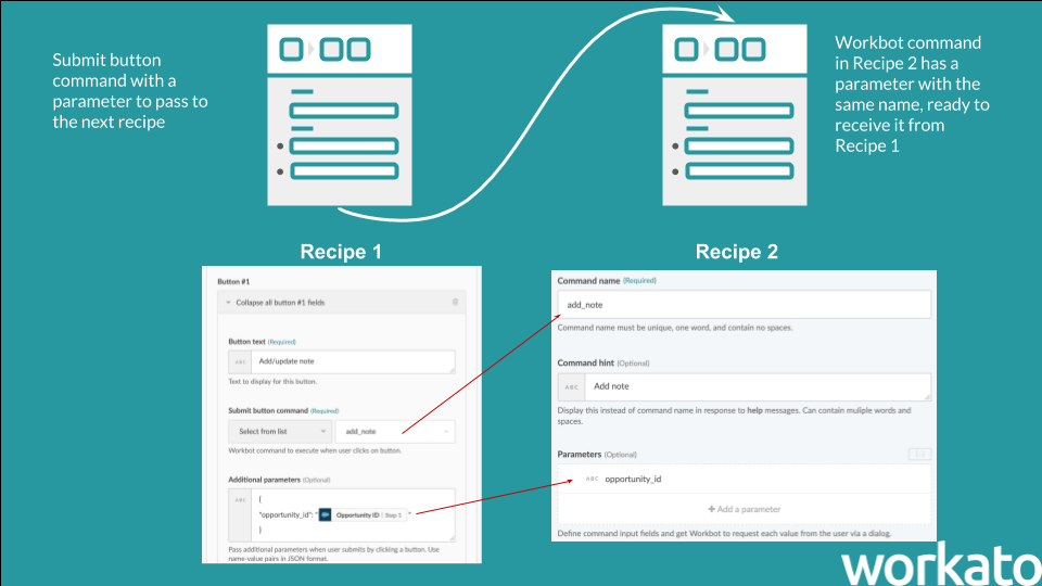

TL;DR: Buttons can be used to chain into other recipes by setting the submit button command (from your 1st recipe) with the command name of the recipe you want to chain into (the 2nd recipe). Parameters can be used to pass context along to the next recipe as well – just remember to include the parameter it’s supposed to receive from the preceding one.
Recipe chaining & passing parameters
Simple diagram on how buttons allow you to chain into other recipes, passing context via parameters.
