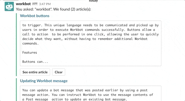

After clicking ‘See entire article’ button, the updated message now has a ‘Clear article’ button

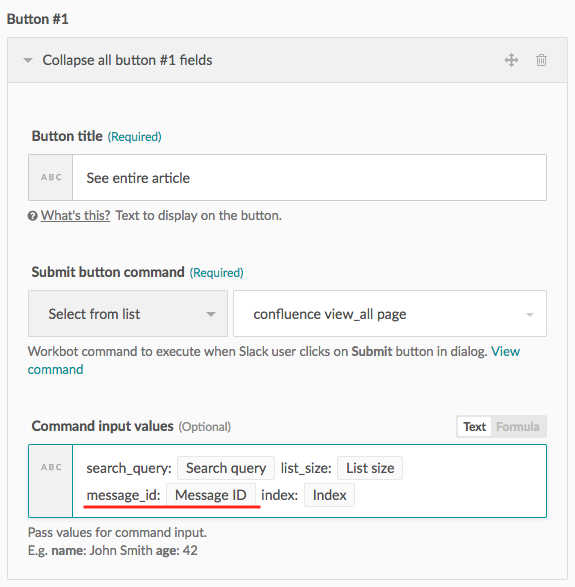

Yes you can! You’ll need to pass its message ID to the recipe that’s updating the message. In general, name-value pairs (up to 5 of them) can be passed on to other recipes by using the Command input values field.
When the button is clicked, the message ID value is passed onto the secondary recipe that the button calls. This recipe is then able to use this message ID to update the corresponding message.

  1. Command input values in buttons (via a post command reply / post message action),
  2. Command input values in menu options (via a post command reply / post message action),

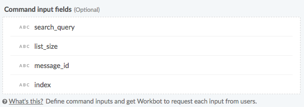

The recipe that’s receiving the name-value pair must also have the fields defined in its command input fields.
The recipe called by the ‘See entire article’ button (shown earlier in this section) has the corresponding field names defined in its Post command trigger’s command input fields
